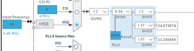

2023-07-14 2:34 PM
Hi Erwan,
I think my problem is rather not directly related to DMA but to the clock or clocks. I remember a similar issue for ETH for STM32MP15x.
Now I connected SAI to PLL3Q and PLL3R. I'm curious about one thing. In the documentation, we can read
that
items:
- description: pclk feeds the peripheral bus interface.
- description: x8k, SAI parent clock for sampling rates multiple of 8kHz.
- description: x11k, SAI parent clock for sampling rates multiple of 11.025kHz.the clock should be multiplied by 8kHz and 11.025kHz accordingly.
I checked the clocks for DK2 and not match perfectly.
What do You think about it?
BR
Michal
