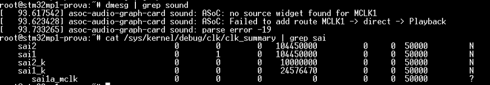

After your suggestion, the previous error is no more present, but I see the following issues:
the sound card does not find the MCLK1 signal and sai1 clock are not enabled ( i do not understand the "?" in hardware enabled column).
The device tree is the same as before but with your line
clocks = <&rcc SAI1>, <&scmi_clk CK_SCMI_PLL3_Q>, <&scmi_clk CK_SCMI_PLL3_R>;
Regards,
Orlando
2023-05-21 12:43 PM
Hi @OPetr.2 ,
It is highly possible that your codec's driver does not enable your master clock when you ask for a Playback. The best way to check it is the oscilloscope, that will answer you clearly.
So now, how to proceed ?
On STM32MP157x series, we have a cirrus codec included inside, and we so declare it and use it in our system. The driver is the cs42l51.c file in sound/soc/codecs/.
On the ST kernel, you can see our modification brought with the commit 318e741ee13b5a72f3051d9bb6852b1f4d02d0bb:
ASoC: cs42l51: fix mclk support
The MCLK clock is made optional for cs42l51 codec.
However, ASoC DAPM clock supply widget, expects the clock to be defined
unconditionally.
Register MCLK DAPM conditionally in codec driver,
depending on clock presence in DT.
Fixes: 5e8d63a726f8 ("ASoC: cs42l51: add mclk support")
Signed-off-by: Olivier Moysan <olivier.moysan@st.com>
Signed-off-by: Mark Brown <broonie@kernel.org>
I advice you to bring the needed modifications in the driver, to enable the MCLK when you ask for a playback, and release it when your playback is over. As concerns the device tree configuration, it is given in the following article for the same example: https://wiki.st.com/stm32mpu/wiki/SAI_device_tree_configuration#Setting_SAI_as_a_master_clock_provider.
Please keep me in touch if you can go forward on this.
Kind regards,
Erwan.
