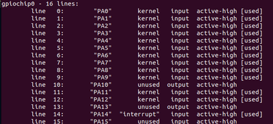

I forgot to add that I try to do this on my custom board which has no physical connection with any USB lines.
MWoło.2
Senior III
The voltage on this PA10 pin is 3.17V, and my VDD is 3.3V.
Command
gpioset gpiochip0 '10'=0
don't change this value
this one
gpioset gpiochip0 '10'=1
also. This pin has to be somewhere configured to USB or another function.
