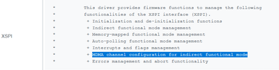

2026-02-12 2:16 AM
2026-02-12 2:31 AM
Maybe better to do a first try using available STM32CubeMP13 bare-metal libraries.
https://wiki.st.com/stm32mpu/wiki/STM32CubeMP13_Package#HAL_drivers
https://www.st.com/en/embedded-software/stm32cubemp13.html#get-software
https://github.com/STMicroelectronics/STM32CubeMP13
Regards.
