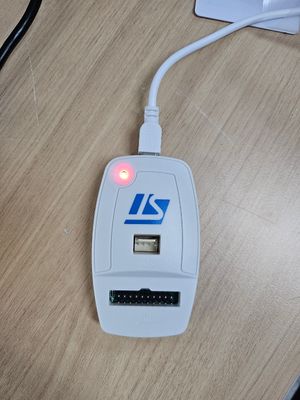

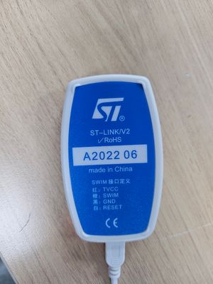

Please provide photos of your ST-LINK/V2 from the rear and front.

Thank you for your response.
Due to an issue with the browser I was using, the language was incorrectly recorded, so I have corrected it to English.
The photo below shows what I have
Regards
SL1
Peter BENSCH
Such connection problems have often been discussed here in the community and in most cases this is due to cheap but unsupported clones from unauthorised dealers. Your ST-LINK/V2 is most likely an illegal clone with a fake STM32F103 and is therefore not recognised as a valid debug tool (see also this Knowledge Base article).

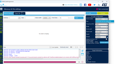

Before you now unscrew your ST-LINK/V2 to check it, you can check it e.g. with the STM32CubeProgrammer:
  • just connect the ST-LINK/V2,
  • start the STM32CubeProgrammer and
  • establish the connection to the ST-LINK/V2 with the button Firmware upgrade on the right.
  • Then start the STLinkUpgrade process, which should first display the 24-digit serial number. The button Open in update mode would then show you the firmware version of the ST-LINK.
However, if the serial number already shows implausible values, e.g. only one letter, it is definitely a fake.
If in doubt, you should actually unscrew the ST-LINK/V2 (two screws under the sticker on the back) and check what kind of MCU is installed. You can find more information here, for example.

Upon checking, the serial number appears to be a single digit (Programmer).
Since the case and appearance are identical, I thought it was a genuine product.

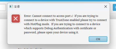

Therefore, I searched for a genuine product and attempted to connect it, but the connection failed

Hi @SL1
you can debug the STM32MP1x family using ST-Link V2.
https://wiki.st.com/stm32mpu/wiki/STM32MP1_Platform_trace_and_debug_environment_overview
But you can't connect to STM32MP1 using CubeProgrammer with SWD/JTAG.
Flashing of MPU products must be done using USB (OTG port for STM32MP1 family).
https://wiki.st.com/stm32mpu/wiki/STM32CubeProgrammer
Regards.
