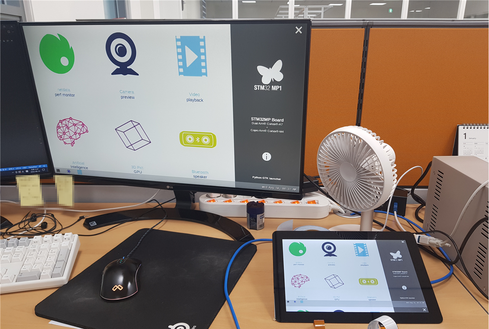

My custom board has RGB(LTDC) and HDMI display interfaces.
We want to display same screen on same time.(duplicate mode)
So, LTDC interface connected to local LCD and HDMI transmitter(sii9022).
<dc node of my dts is below ..
<dc{
pinctrl-names = "default", "sleep";
pinctrl-0 = <<dc_pins_mx>;
pinctrl-1 = <<dc_sleep_pins_mx>;
status = "okay";
/* USER CODE BEGIN ltdc */
port {
#address-cells = <1>;
#size-cells = <0>;
ltdc_ep0_out: endpoint@0 {
reg = <0>;
remote-endpoint = <&sii9022_in>;
/* USER CODE END ltdc */
};and we can display both screen successfully as below picture.

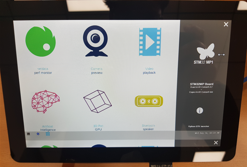

However, unfortunately my LCD`s resolution is 1280x800.
and linux platform doesn't have this HDMI resolution mode.
so my LCD was displayed as below...
