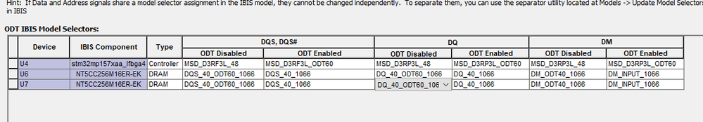

However, I'm confused about which ODT models I should choose.
Please help me which model I chose to pass this check.
By the way, I attached the odt model page screen.

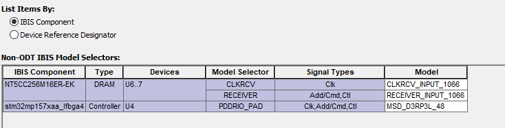

How did you identify them? If I change parameters in CubeMX, do I need to change them too?

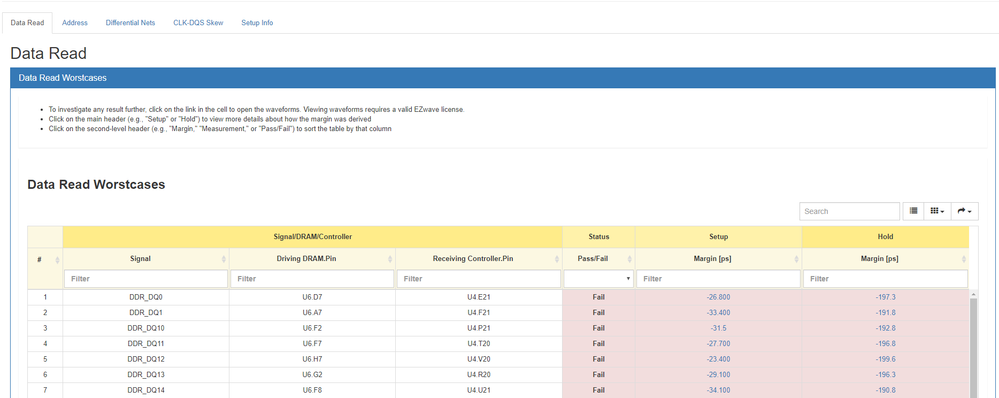

Also, when ODT is disabled, for DRAM, DQS40_ODT_60_1066 is right?
I attached the config image, is right?
0693W00000D17IgQAJ.png0693W00000D17QoQAJ.pngIf yes, it fails;

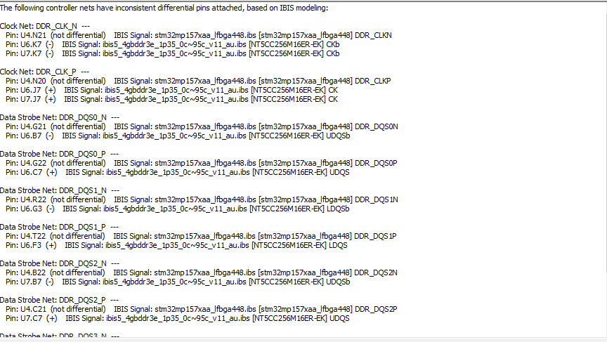

0693W00000D17QUQAZ.pngAlso, Hyperlynx gives a warning about MP1 Ibis data.

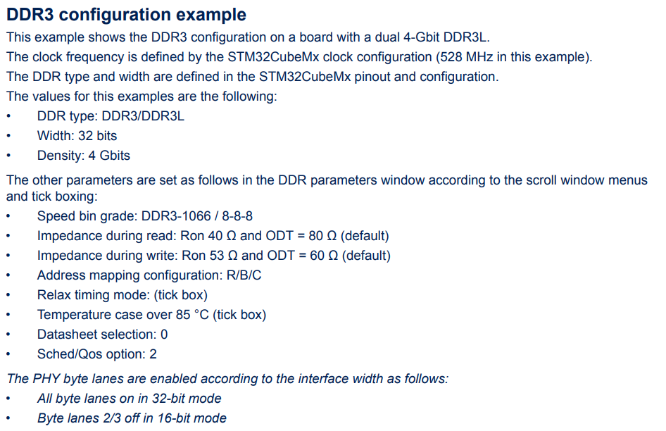

Your ref guide gives Ron and ODT the following image, why do we use 60ODT and 48R?
