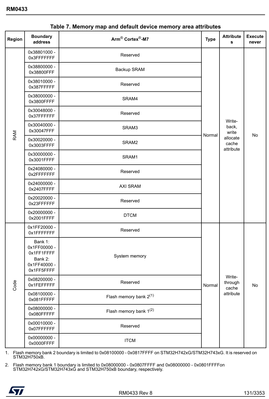

Does anyone have a memory map for the STM32H743XGH6?
2025-02-12 6:31 PM
The reference manual does.
STM32H742, STM32H743/753 and STM32H750 Value line advanced Arm®-based 32-bit MCUs - Reference manual
