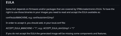

nukersson
Associate II
Adding `ACCEPT_EULA_$(MACHINE)="1"` to `build/conf/local.conf` shall also work.
jialu88
Associate
I am running exactly the same issue when I build firmware for the mp2 chip (surprisingly, it worked on mp1 with non-secure mode)
As @nukersson mentioned, by adding `ACCEPT_EULA_$(MACHINE)="1"` should just work.

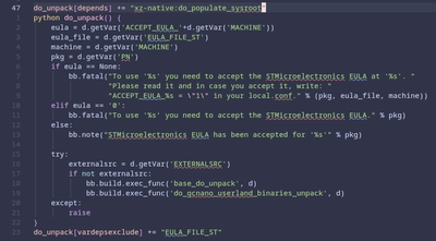

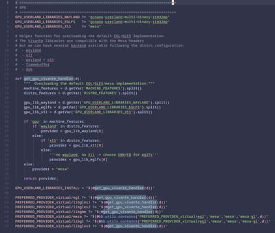

Just providing a bit more context for those who do not choose `open-stlinux` as upstream image:
EULA:
meta-st-stm32mp/recipes-graphics/gcnano-userland/gcnano-userland-binary.inc from line 47:
meta-st-stm32mp/machine/include/gpu_vivante.inc
So `ACCEPT_EULA_$(MACHINE)="1"` will enable `gcnano-userland-multi-binary-stm32mp` (which is a closed-source driver for Vivante GPU)
