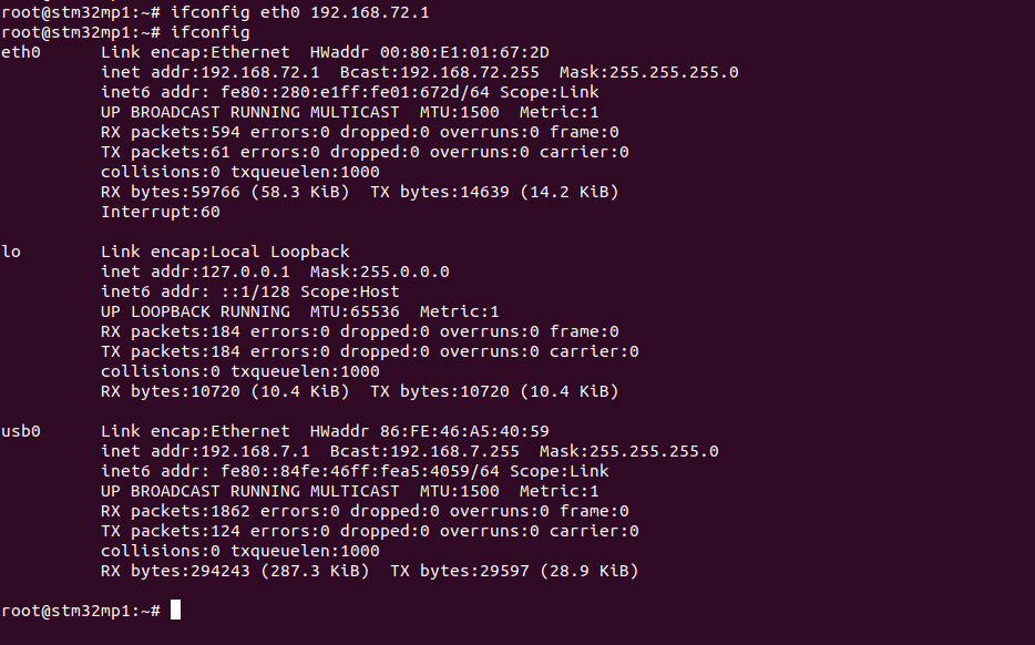

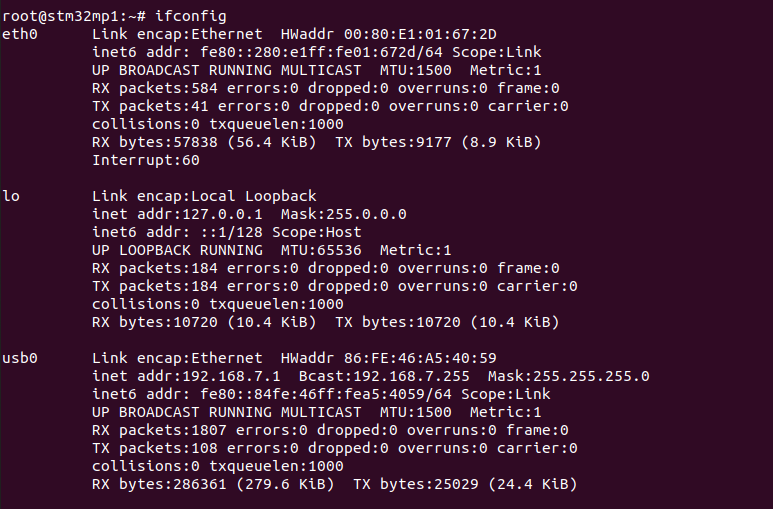

Firstly command "ifconfig" on my board:
Ifconfig responds eth0 that has not IP adress. Therefore I set manually IP adress this command and type ifconfig again:

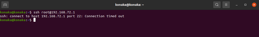

Finally on my host computer, I want to connect the terminal to the board using ssh:
I take ssh: connect to host 192.168.72.1 port 22: Connection timed out error

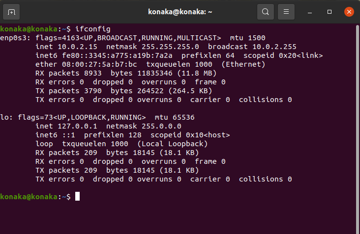

The command ifconfig on my Ubuntu PC
Thanks

Hello @Emre Avcı ,
From what I see with your screenshot, you don't have a subnet shared between your board and your PC so you can't communicate between them.
For example, on my PC with my DK2 plugged via usb0 (ethernet):
The IP of the board is 192.168.7.1

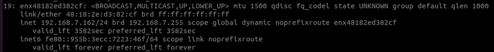

and on my PC Ubuntu:
My IP is 192.168.7.162
The subnet of my PC and my board is : 192.168.7

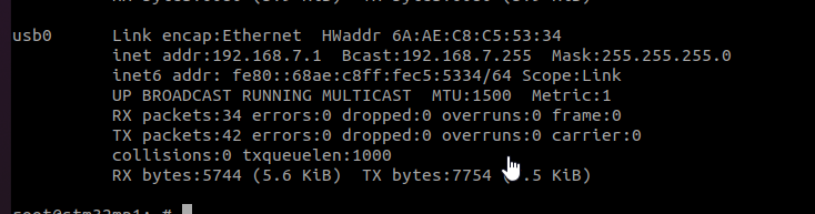

rtt min/avg/max/mdev = 0.888/326.706/977.157/459.938 msPlease read some pages on internet about how the subnet works, it will help you to understand this behavior.
On your first screenshot, you have an interface usb0 with an ip 192.168.7.1, but on the PC, you do not have this new interface. Is it normal?
And do you really need to access by SSH with the port ethernet? Or can you use the usb0 interface?

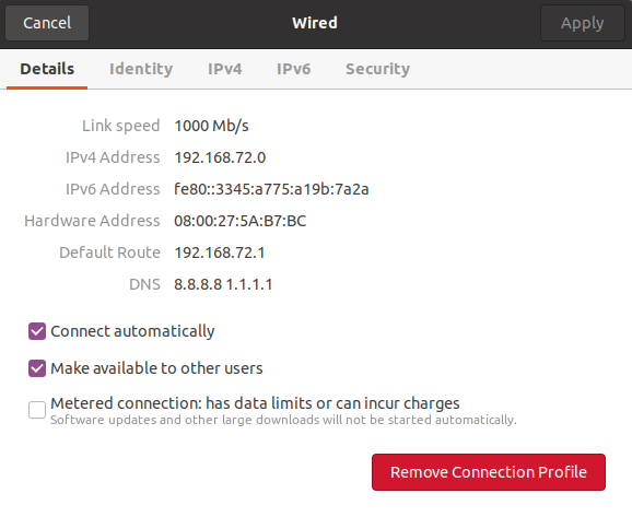

$ sudo ip route add 192.168.72.0 via 192.168.72.1but still there is no connection between Pc and Board.
I configure eth0 as Static IP Adress:

RX bytes:1004585 (981.0 KiB) TX bytes:415025 (405.2 KiB)And I configure my Host PC IP Adress as Static IP Adress:
