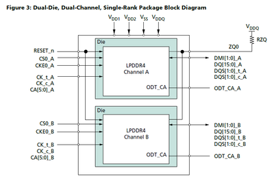

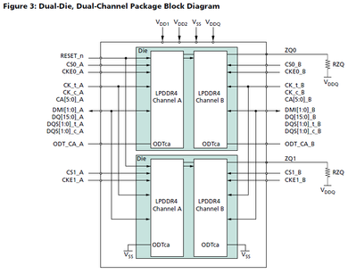

The major thing to look for is that it should be a single rank memory.
For LPDDR4 (i.e. single CS per channel), it is not always clear inside memory datasheets.
For DDR3L or DDR4 (should be single rank as well), it is simpler, and all JEDEC x16 with frequency above respectively 1066 and 1200 MHz should work.
See also Guidelines for DDR configuration on STM32MP2 MPUs
Looking at the references you mention, the revision B (Z42M) is NOT single rank (look at CS1_A and CS1_B)
While the revision C (Z42N) is single rank. So ok for STM32MP2.
