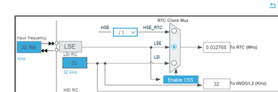

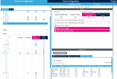

Also checked the RCC_BDCR @ 0x50000400 and the returned value is 0x00100035 which means RTCSRC[1:0] register is 0. That means it is not selecting any other clock source (LSE, LSI and HSE/DIV). I have tried to change and select every clock source configuration from CubeMX using RTC Clock Mux, no luck. It doesn't choose a clock source and it stays conneted to 0.

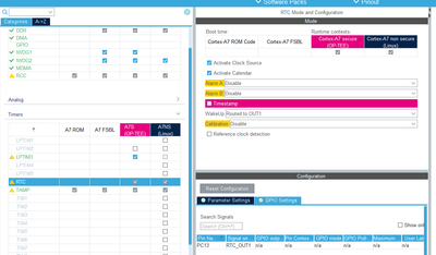

2024-02-21 6:23 PM
Cube MX Configs for RTC.
