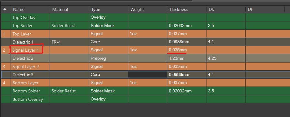

2024-04-09 8:03 AM
So all signal lines should be at the top layer and below the signal lines, the laywer below, it should be the 3.3V plane?
Signal layer 2 is very close to top-layer.
