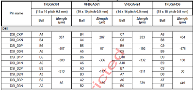

Furthermore, DSI data were missing for D2 and D3, here are the values:
As a working reference, you could also look at STM32MP257F-DK or STM32MP257F-EV1 design files.
