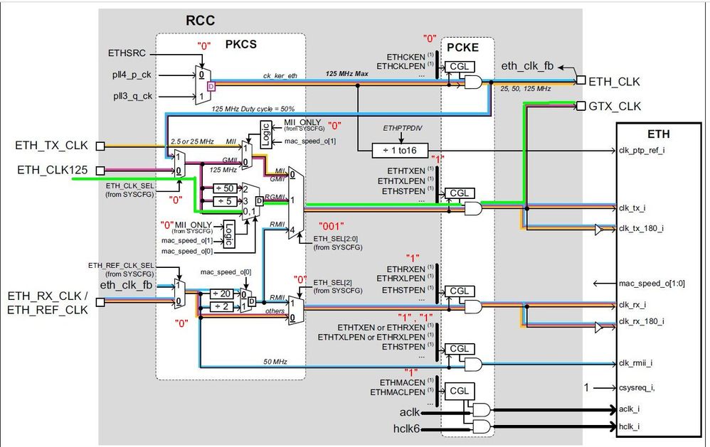

The PHY has 25MHz external clock, it gives 125MHz RX_CLK clock to the MAC, and the MAC would have give 125MHz TX_CLK (as GTX_CLK) to the PHY.
But with auto-negotiation the output on TX_CLK is only 25Mhz as 100Mbps.
This readable in the MAC registers:
devmem 0x50000A10 w 0x10800
devmem 0x50020004
0x00200000
devmem 0x500008FC
0x00000000
devmem 0x50000218
0x01004701
devmem 0x5800a000
0x0807E203
here ought to be 0x08072203 but the mac_speed_o[1] bit is "0" after negotiation.

Yes I read the wiki you mentioned several times and I use the
"3.3.4 RGMII with Crystal on PHY, CLK125 from PHY (Reference clock (standard RGMII clock name) is provided by a Phy Crystal)" description.
I have external 25MHz oscillator on the PHY, it gives 125MHz clock to the STM32 processor on pin ENET_CLK125 PG5 and ENET_RXC on pin PA1. The processor need to give 125MHz clock to the PHY on pin ENET_TXC PG4.
