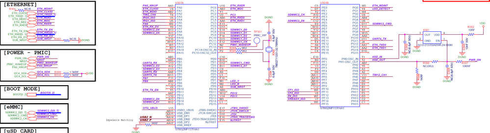

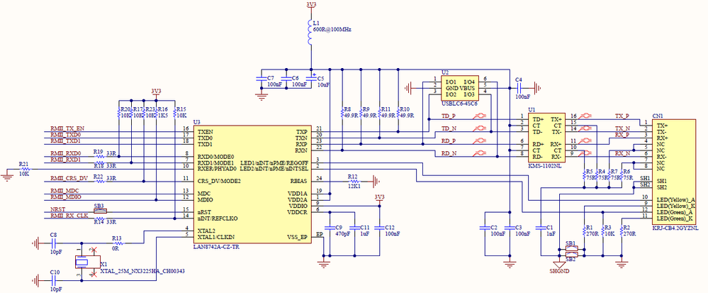

2021-09-01 7:03 PM
Yep, my pc ssh connect to the outside, ping, apt-get, etc. works without problems.
So I don't think it's a security setting issue.
Currently, my ethernet circuit configuration is as the attached picture.
According to the configuration, the Device Tree has been changed to the first configuration in your link.
I am using Distribution Package, and I am using Cube-MX by changing the Device Tree of 157F-EV to fit my circuit (meta-st-stm32mp-addons/mx Directory)
In the team project circuit, MPU and Ethernet IC exist on the same board, but The RJ45 connector is connected to the Ethernet IC through two boards.
So I'm thinking it's a circuit problem like impedance or noise.
However, I'm assuming it may be a problem with the BSP configuration.
So I would like to know if there is another Test method, and need to change the BSP configuration.
If you need, I can attach my MX Device Tree.
Regards.

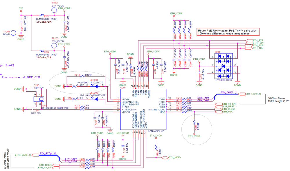

2021-09-01 11:24 PM
So, you confirm that the :
work on your Linux PC (that's sound normal), but fail when commands are issued from your STM32MP157F board console.
Could you share the error messages ?
If the board get an IP address (as we see in ifconfig you copied), it mean the board is already able to discuss with your network DHCP server.
From HW point of view, I did not see any evident issue.
Please double check the magnetic transformer and RJ45 pinout which are not part of this abstract, maybe some mixed-up there.
I don't think noise or impedance could make it not working at all.
If it helps, here is one of our RMII reference design working with the first link DT
Regards.
