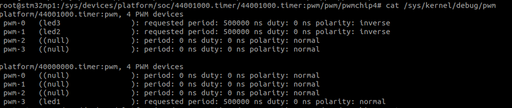

If I verify the pins used by doing "cat /sys/kernel/debug/pinctrl/soc:pinctrl@50002000/pinmux-pins", I can see:
pin 125 (PH13): device 44001000.timer:pwm function af3 group PH13
pin 126 (PH14): device 44001000.timer:pwm function af3 group PH14
pin 3 (PA3): device 40000000.timer:pwm function af1 group PA3So it looks good.
Then if I follow the debug chapter of the wiki page: https://wiki.st.com/stm32mpu/wiki/PWM_overview#How_to_monitor_with_debugfs
I can see that led1,2 and 3 are well configured.

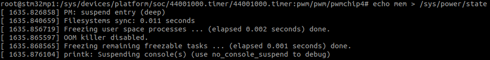

But unlike you, I'm able to go in low power mode by calling "echo mem > /sys/power/state". As explained in the wiki: https://wiki.st.com/stm32mpu/wiki/Power_overview#API_description
I also tried on a DK2 board and I got the same result.
So right now, I'm not able to reproduce the problem on my side.
