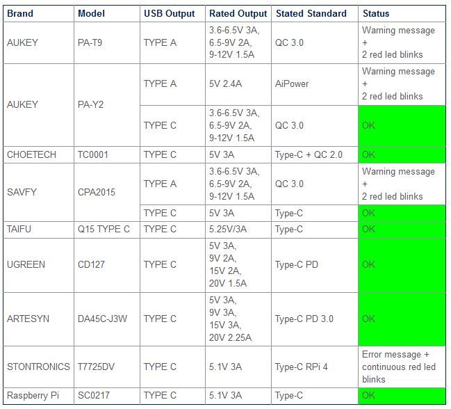

Power supply is usually not an issue if it could provide more than 1A (more current are required only for intensive usage, but also 2A are provisioned to supply the 4 x USB Type-A of the DK2 with up to 500mA each).
With some supplies, you could see the red led blinking one or two times to indicates that the Type-C supply has not been detected as 3A (could be also because it is not 100% Type-C compliant or using a Type-A <-> Type-C cable). This is a warning only and does not stop the boot process.
Some supplies are even not detected at all as a Type-C, then the red led is kept light and the boot process is stopped.
Here are some list of tested supplies (without any ST endorsement as model could change without notice):
For details on console message and red LED blinking signification, see Populate the target and boot the image.
