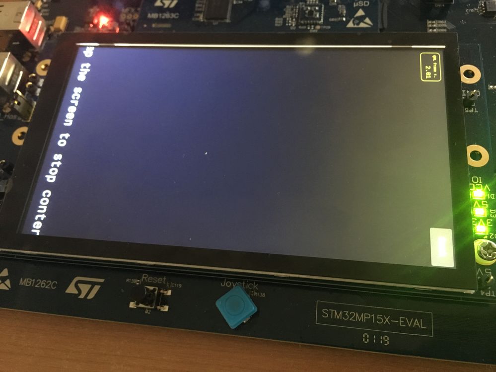

2019-07-30 10:14 PM
This example can't play the video. A black screen always seems. I attached a screen of it.
