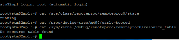

2020-04-16 2:01 AM
Hi @fwajie jspa
Indeed, the FW is blocked in OpenAMP_Init function through rproc_virtio_wait_remote_ready(vdev) until the kernel start the TTY.
If still stuck after Linux boot there 2 things to check :
1 - Linux properly detect firmware is running :
if not the case check you properly set « early-booted » option in DT Linux ( cat /proc/device-tree/m4@0/
2- resource table should be present and properly read
you should see entry points vdev, « Vring 0 » and « Vring1 »
Else check you properly integrate a resource table in your elf.
Hope it help,
Olivier
2020-04-17 2:06 AM
Here is the response:
Is there something I must do to the kernel? it seems the kernel isn't ready to sync with early_boot processes
2020-04-19 11:40 PM
Hi @fwajie jspa
You have to define a resource table in your coproc .elf.
See https://wiki.st.com/stm32mpu/wiki/Coprocessor_resource_table
Most of example provided in STM32Cube_FW_MP1 package such as OpenAMP_TTY_Echo implement it properly for reference.
Hope it help
Olivier
