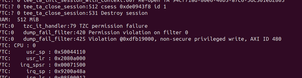

Just got the same error in a 512MB board. How to fix this ?
OP-TEE DT:
memory@c0000000 {
device_type = "memory";
reg = <0xc0000000 0x20000000>;
/* USER CODE BEGIN memory */
/* USER CODE END memory */
reserved-memory {
#address-cells = <1>;
#size-cells = <1>;
ranges;
/* USER CODE BEGIN reserved-memory */
optee_framebuffer: optee-framebuffer@dd000000 {
/* Secure framebuffer memory */
reg = <0xdd000000 0x1000000>;
st,protreg = <TZC_REGION_S_RDWR 0>;
/* USER CODE END reserved-memory */
and U-boot:
memory@c0000000 {
reserved-memory {
#size-cells = <1>;
ranges;
reserved-memory {
#size-cells = <1>;
ranges;
optee_framebuffer@dd000000 {
no-map;
optee@de000000 {
reg = <0xde000000 0x02000000>;
no-map;
0xDD0000000 was used as posted in the below WIKI , assuming that is the area to be used for 512MB
Though, This WIKI is for STM32MP135. There is no WIKI version for STM32MP15 (in my case 512MB) or any information ho to configure this for different CPU and memory configurations.
Same issue :https://community.st.com/t5/stm32-mpus-products/op-tee-error-on-new-v5-0-0-sdk/m-p/578239
