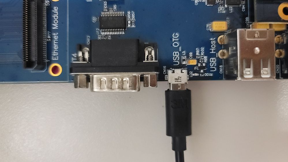

Which USB port of EV1 board do you connect to PCs ?

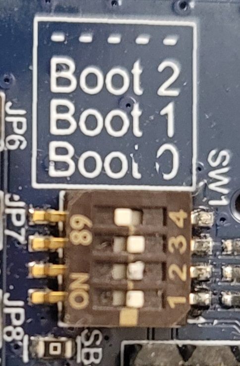

You might use USB_OTG port from mother board CN16 and all boot pin to 0 ( USB boot mode)

I use the USB port of CN16's USB_OTG port. This port has been used to verify that it is connected in Windows OS. And I checked that VMWare-Ubuntu 20.04 is not connecting.
I am attaching a picture of the used USB port and boot mode.
