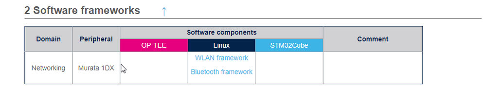

The software framework needed to make the murata 1DX works is only available under linux (A7Core).
As specified on the wiki related to WLAN: https://wiki.st.com/stm32mpu/wiki/WLAN_and_Bluetooth_hardware_component#Software_frameworks

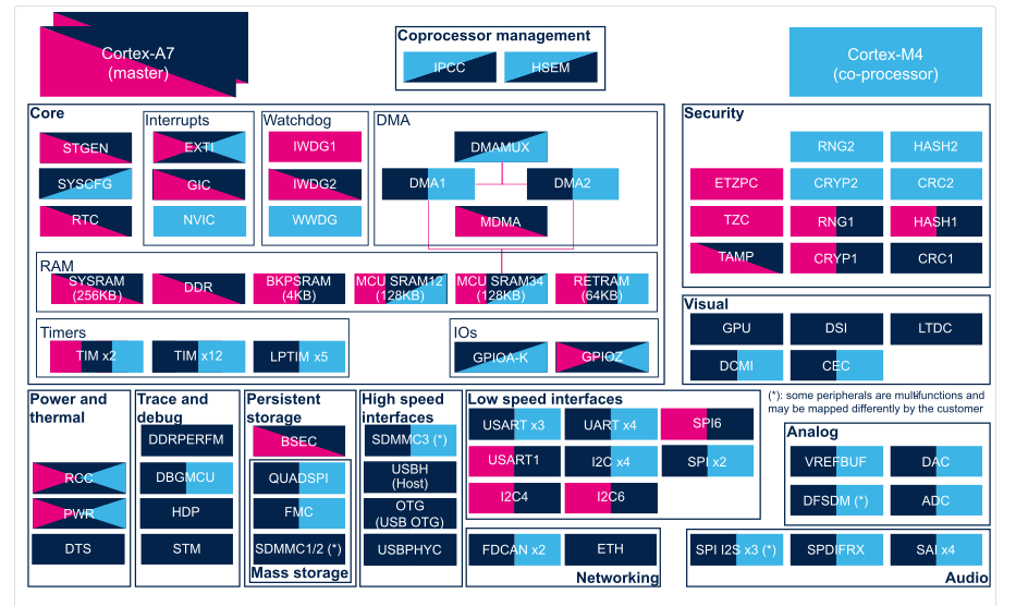

It is explained in the Peripherals overview page that sdmmc2 is CortexA7 only:
https://wiki.st.com/stm32mpu/wiki/STM32MP15_peripherals_overview#Internal_peripherals_overview
So you can't use the module muRata 1Dx with core-M4 only.
