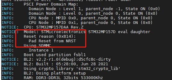

my board have not use pmic and i use poweroff close the board. it will reboot and tf-a report reset reason (0x814) for NRST

i have two version hw. ver.1 can use poweroff to close, but ver.2 can't both have same power support. ver.2 use poweroff and it will be go into bor_rst and reset the board.

When you shutdown supplies including VDD, it is normal behavior to get a NRST=0 when VDD became too low. This cannot be avoided.
For example, if you use a GPIO output to start an HW shutdown to your supplies, the NRST=0 will put back all GPIOs to high-z which might put the power supplies back to ON state.
It is up to your board HW to ignore this and continue the HW shutdown sequence until complete platform power-off.
it is usually tricky to have such power on/off HW mechanism reliable. STPMIC1 is more handy for doing this.
