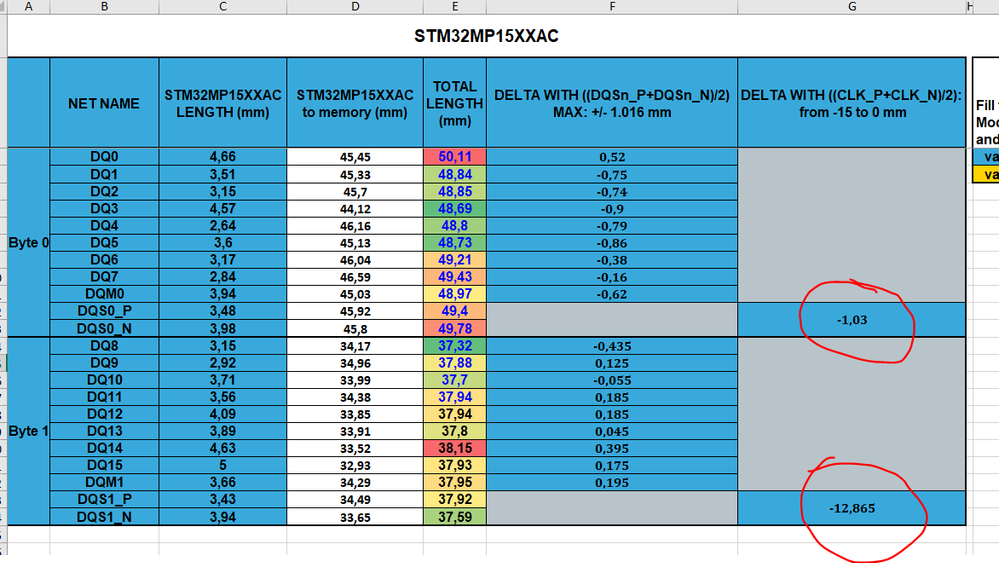

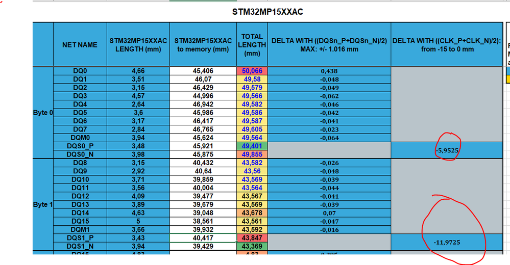

Then I measured DDR_Q1 to DDR_7, DQM0, DQS0_P and DQS0_N and filled the Excel table that is included inside the downloaded .zip file.
Here is the result:

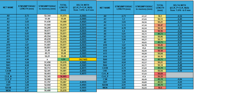

But when I look at the Excel spred sheet that ST have made, they show me these numbers.
My question is: What are ST doing to getting the length of DQ0, DQ1, DQ5 and DQ6 ? It seems that they are the only ones that differs. Others seems to be similar.
If they are changed in the model, but not in the Excel spred sheet, which values should I follow? The values made by ST, or the hard ware example model made by ST?

Hi @DMårt
checked the STM32MP15XXAC_1DDR3L. For me it is OK.
DDR_CLK_N reported by Altium Designer to have a total length of 49.769mm (This includes the 2 x vias for 1.534 each).

The wire going to the 100 ohms is reported to be 2.738mm long (values in red above)
so, final DDR_CLK_N length is : 49.769 - 2.738 = 47.03mm, which is the value in the excel
I think you accounted the 2 x vias twice.

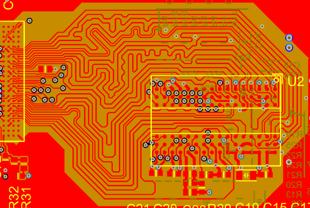

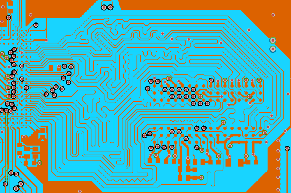

Anyway! I hade to re-route everything because I found two critical things:
  1. The minimal electrical clearance was 0.08mm between track to track
  2. The minimal eletrical clearance was 0.08mm between pad edge to track
I changed that to 0.1mm but with one exception of BGA pad, there I configure the DRC rule to 0.09mm between pad to track because JLCPCB can only produce with a minimum 0.1mm electical clearance, with an exception to BGA pads. JLCPCB will cut the edge of the pad if a track of 0.09mm in width passing through a BGA with pitch of 0.5mm.
One major difference I made is to change this. This is a print screen from Altium 365.
To this. This is a print screen from Altium CircuitMaker.
That resulted:
The Byte0 has only a minor change. But byte1 has a major change. Also the track width is 0.09mm due to the impedance.

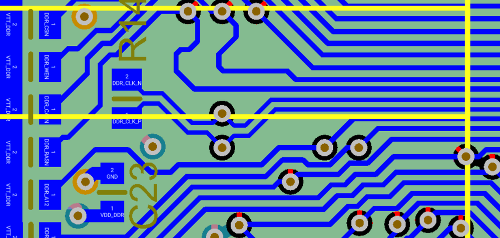

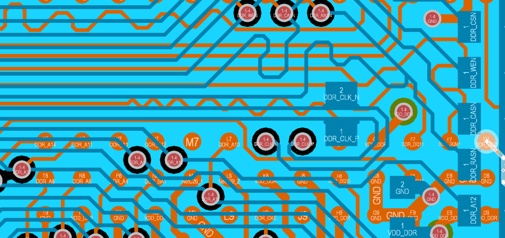

One more difference is this. The upper is mine. The lower is from ST.
I don't like to be close to the limit.
