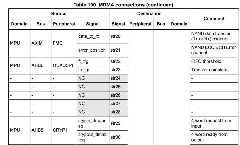

I am in purpose of developing driver of the peripheral CRYP1 with MDMA on STM32MP157C-DK2 board.
I refer to STM32MP157 advanced Arm®-based 32-bit MPUs - Reference manual(RM0436),
firstly in page 1160, CRYP1 is AHB5 source, and two stream are supported to MDMA,

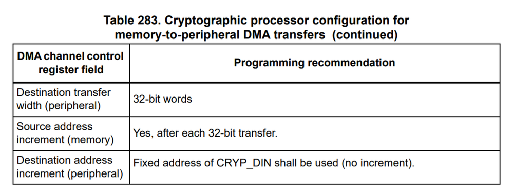

and at page 2025, CRYP_DIN address must be fixed.

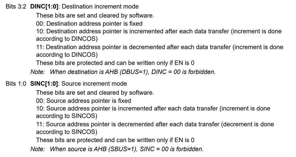

However according to description of MDMA address update configure register(MDMA_CxTCR) at page 1181,
configuring DINC and SINC , address pointer fix is forbidden when AHB bus setted.
In addition, setting DBUS and SBUS in MDMA_CxTBR, cannot be writen even eEN bit is 0.
