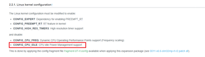

Dear all:
I am currently using the distribution version:
V5、rt 6.1.82-rt patch、stm32mp257
Prompt in Wiki,need disable CONFIG_CPU_IDLE,But in reality, it cannot be closed.
Why am I paying attention here? Because I encountered an Oops exception during running.

Christophe Guibout
Hello @bugman,
CPU_IDLE is kept enabled on Arm64 due to dependencies with ACPI, so the wiki needs to be updated accordingly, as well as the RT ARM64 kernel fragment (arch/arm64/configs/fragment-07-rt.config).
So now, the kernel panic becomes relevant to investigate : I've not been able to see it by testing with cyclictest : could you please detail how to reproduce the kernel panic issue ?
BR,
Christophe

echo 1 > /sys/devices/system/cpu/cpu0/cpuidle/state1/disable
echo 1 > /sys/devices/system/cpu/cpu1/cpuidle/state1/disable
echo 1 > /sys/devices/system/cpu/cpu1/cpuidle/state0/disable
Then, you can also try to disable one core and check if you could have a race condition:
echo 0 > /sys/devices/system/cpu/cpu1/online
BR,
Christophe
