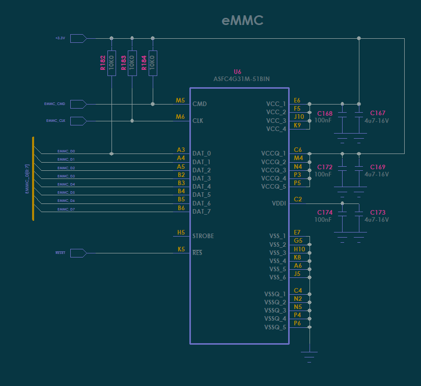

Here is information about the PCB:
- 8 layer
- We only use 3.3V for the emmc, on both power domains
- Here is how the emmc is connected

2024-01-10 4:23 AM
No series resistors? Usually designs have 27R or 33R to stop ringing. Traces also need matched lengths.
DDR implies data on both clock edges. DDR104 would have 52 MHz clock, not 104 MHz, although clock within peripheral will likely be higher internally.
Throughput on eMMC dictated by device, different brands have different performance.

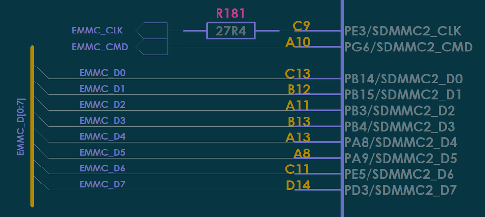

2024-01-10 4:44 AM
Only series resistor on EMMC_CLK line. (See attached photo below)
We read this out from our kernel:
clock: 52000000 Hz actual clock: 27000000 Hz vdd: 21 (3.3 ~ 3.4 V) bus mode: 2 (push-pull) chip select: 0 (don't care) power mode: 2 (on) bus width: 3 (8 bits) timing spec: 8 (mmc DDR52) signal voltage: 0 (3.30 V) driver type: 0 (driver type B)
And after running multiple threads it falls back to:
cat /sys/kernel/debug/mmc1/ios 2000-01-01 01:04:39 clock: 52000000 Hz actual clock: 27000000 Hz vdd: 21 (3.3 ~ 3.4 V) bus mode: 2 (push-pull) chip select: 0 (don't care) power mode: 2 (on) bus width: 2 (4 bits) timing spec: 8 (mmc DDR52) signal voltage: 0 (3.30 V) driver type: 0 (driver type B)

@PatrickF wrote:Did you have checked signal/power integrity on your board ?
We are measuring D0 and CLK to see if any ringing or distortion is present on the signal. Currently we are running into issues with out probes not being capable to measure at those frequencies. Our latest measurements indicate good signal integrity, I will post a screenshot from the oscilloscope tomorrow.
@PatrickF wrote:Is the serie resistor on SDMMC2_CLK close to signal source ?
Yes, according to our EDA tool, 3.75 mm from pad to pad. The series resistor is on same layer as IC, so getting it any closer would require us to move it to the opposite side.
@PatrickF wrote:Is the eMMC far away from STM32MP15x ?
Each trace is matched withing 10 mil (0,254 mm) and each trace is 27,7 mm long (CLK, CMD D0-D7).

2024-01-10 7:26 AM
Our signal path lengths are 27 mm from pad to pad.
Perhaps our drive strenght is too much or what when at these shorter distances?
