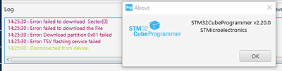

I’m having an issue with flashing OpenSTLinux Android (OpenST-Droid) on the STM32MP257F-EV1 board.
I followed the instructions in the following document:
STM32MPU Distribution Package for Android - stm32mpu
How to build OpenSTDroid distribution - stm32mpu
How to populate boards for Android - stm32mpu
However, when I start the flashing process using STM32CubeProgrammer, it stops at 0x01 and does not proceed further.
Could anyone help me understand what might be causing this issue, and how to resolve it?
Thanks in advance!
2025-07-07 11:32 PM
I would like to add that my CubeProgrammer version is V2.20.0.
I also tried downloading and flashing using the STM32MP2 OpenSTDroid Starter Package, but the result was the same.
STM32MP2DroidSta - STM32MP2 OpenSTDroid Starter Package - STMicroelectronics
2025-07-08 12:43 AM
Sorry, I found that my board, STM32MP257F-EV1 (MP257F_X-A01), does not seem to support the current version of Android, which is likely the reason why the flashing failed.
I would like to ask if there is an image available for this specific version? Thank you.
