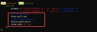

2024-06-25 10:08 PM
drive-push-pull is wrong for I2C. It is always drive-open-drain
hth

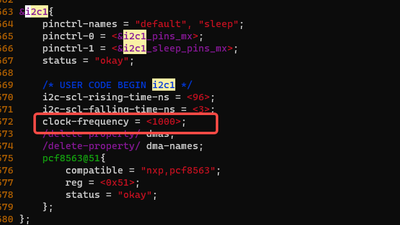

2024-06-25 9:37 PM
I reconfig the dts tree of i2c1,use inner pull-up and 1K baurate seems not work too
2024-06-25 10:08 PM
hth
