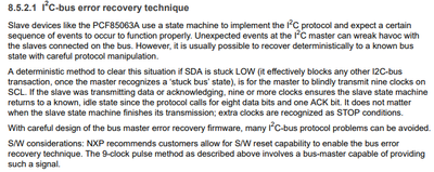

have you tryed this suggestion from the datasheet?
seems like that is what you may be facing.
hope it helps.
greetings

Hi @urbito,
yes, I saw the note but I'm not yet be able to apply it, and then reset the chip.
But I'd like to know the cause of the problem! Just to avoid it.

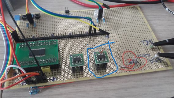

The schematic is very basic: so far, we have only a hand-wired board.
The communications with other chips are ok, on the same I2C bus.
The RTC chip on the board does not have the backup battery and capacitors.
