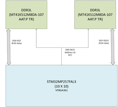

can I use 2 , 8bit DDR3L with STM32MP257FAL3 (as this is not mentioned in the pdf you provided), to achieve 1GByte Memory density.
Best Regards
Abhineet Ranjan
2025-09-30 10:05 PM - edited 2025-09-30 10:06 PM
Block Diagram for reference....
