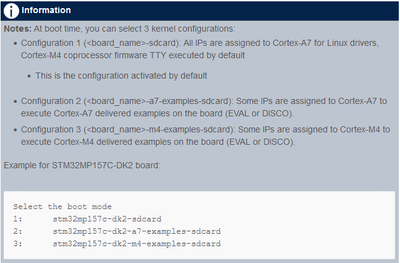

Well, I managed to resolve my "bonus" problem. Turns out I need to ensure I have the M4 examples mode selected, so I have a few things I need to figure out related to the startup at this point:
1) How do I setup the startup so that it:
a) Selects the M4 Examples option without needing to be prompted
b) Starts up the M4 project on startup (as described above)
2) I need to find out what selecting the 3 different options at startup are actually doing (are they configuring the device tree differently?) What is it doing differently in the M4 startup from the plain OpenSTLinux?
Any chance someone can point me the right direction where to look to find this info?

yes, starter package allows to choose different device tree for Linux kernel in order to run examples.
https://wiki.st.com/stm32mpu/wiki/STM32CubeMP1_Package#Introduction_to_boot_mode

Thanks for the quick reply! As per my update post, I managed to get the errors to go away by selecting the M4 examples from the Starter package, which at least gets my program running.
My current goal is to setup a project that can get access to the M4 peripherals (so, effectively select the M4 peripherals automatically without being prompted) and to automatically start running the A7 firmware without being prompted with the example linux commands shown below:
