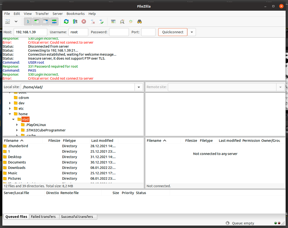

I'm using MYD-YA15XC-T board based on stm32mp151 kernel 5.4.
And wanted to share files with it via FileZilla ftp/sftp file manager on the PC.
But i could not connect to the board, there is always login incorrect error, whichever login or password I try to use:
My board uses automatic login, so there is no password that i know, really.
And i believe the openssh-sftp package is installed.
Do i missing something for sftp/ftp connection to work?
Regards, Vlad.

Hello Jean-Marc B (ST Employee)
I have checked and got that the openssh-sftp is installed indeed and apt-cache policy openssh-sftp
command output is just the same as yours.
But trying to connect results in error:
vlad@vlad-MS-7C71:~$ sftp root@192.168.1.39
root@192.168.1.39's password:
sh: /usr/libexec/sftp-server: not found
Connection closedIt seems that sftp-server is missing.
I removed openssh-sftp by apt-get remove openssh-sftp but when trying to reinstall it again by apt-get install openssh-sftp got another error:
root@myir-ya151c-t:~# apt-get install openssh-sftp
Reading package lists... Done
Building dependency tree
Reading state information... Done
Package openssh-sftp is not available, but is referred to by another package.
This may mean that the package is missing, has been obsoleted, or
is only available from another source
E: Package 'openssh-sftp' has no installation candidateWhat should I do?
Regards, Vlad.
