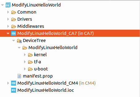

2021-04-20 8:50 AM
Yes it is installed.
2021-04-20 8:57 AM
Ok, so now you can import OSTL projects as explained here: https://wiki.st.com/stm32mpu/wiki/How_to_manage_OpenSTLinux_project_in_STM32CubeIDE
I do not see them in your screenshot...
Take care that downloading and installing SDK is quite long. It should end-up with a SDK Install success pop-up.
Ludovic

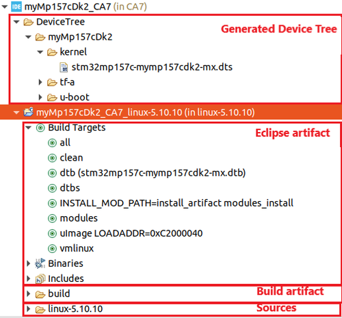

2021-04-21 12:36 AM
Hi VWied.1,
If your SD-Card contains Starter Package : OpenSTLinux binaries, and if you want to use a resource on Linux Cortex-A7 side, only an update of Linux device tree is needed.
This can be done with Linux project Build target dts (***.dtb) . Then, you can update your board following https://wiki.st.com/stm32mpu/wiki/How_to_manage_OpenSTLinux_project_in_STM32CubeIDE#Linux_project
Take care to update the extlinux.conf file corresponding to your board in order to take into account your new Device Tree.
This can be check in boot message on the Device Tree prompt in u-boot.
Does this answer to your need?
Ludovic
