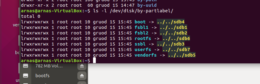

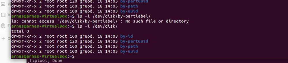

I also tried opening the SD card directlly on linux but the FIP storage does not appear:

Regarding FIP, it is normal that you do not have FIP partition because you are using a partition scheme to use an U-Boot SPL.
I forgot that point during the previous answers.
So I explained you how to generate an image with a FIP package which is the normal way to use the environment v3.1.0, but it was not related to your main question.

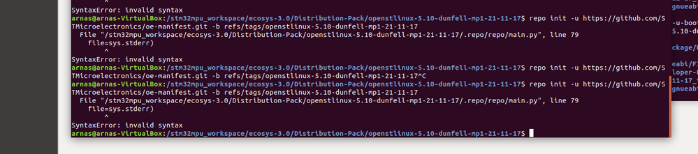

I have tried "How to populate the SD card with dd command" (url: https://wiki.st.com/stm32mpu/wiki/How_to_populate_the_SD_card_with_dd_command). But this requires the Distribution Package. Then I have followed the "https://wiki.st.com/stm32mpu/wiki/STM32MP1_Distribution_Package" to get the distribution package and got the following error to repo init ****. :
repo init -u https://github.com/STMicroelectronics/oe-manifest.git -b refs/tags/openstlinux-5.10-dunfell-mp1-21-11-17
 File "/stm32mpu_workspace/ecosys-3.0/Distribution-Pack/openstlinux-5.10-dunfell-mp1-21-11-17/.repo/repo/main.py", line 79
  file=sys.stderr)
SyntaxError: invalid syntax

No need to get the Distribution Package right now. The Distribution Package is a package that can be used when you want to generate your own linux and filesystem.
It is too advanced for what you want to do.

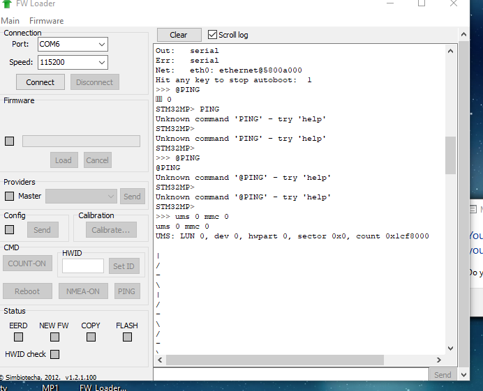

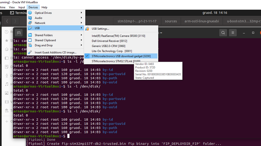

Ok so perhaps you have an idea why my VM does not detect the USB OTG.
1.Reboot board and set the "ums 0 mmc 0" massstorage mode:
0693W00000Hp5ZuQAJ.png2.The masstorages (multiple) appear on windows.
0693W00000Hp5a9QAB.png3.Then I try to access the storage on my VM.
0693W00000Hp5aYQAR.png4.then i try to access it on the VM - but it does not detect the massstorage for some reason
0693W00000Hp5aiQAB.pngPerhaps any idea what is causing the issue?
I am using OracleVM.
I have tried following this to allow USB 3.0 devices input on VM:https://techsviewer.com/how-to-install-virtualbox-extension-pack-and-enable-usb-3-0/
But no luck, After selecting Devices->USB->STxxxx USB download gadget, the mass-storage device dissapears from windows but does not appear on oracle-VM. Also tested this with normal mass-storage device plugged to windows then selecting it via VM - works fine.

ok so so I switched from VM to dedicated PC and now I have no problems accessing the board as masstorage with "ums 0 mmc 0". I can fully access the device board now. And this is what i see:
ls -l /dev/disk/by-partlabel/
total 0
lrwxrwxrwx 1 root root 10 gruod. 22 12:48 boot -> ../../sdb4
lrwxrwxrwx 1 root root 10 gruod. 21 22:55 'EFI\x20System\x20Partition' -> ../../sda1
lrwxrwxrwx 1 root root 10 gruod. 22 12:48 fsbl1 -> ../../sdb1
lrwxrwxrwx 1 root root 10 gruod. 22 12:48 fsbl2 -> ../../sdb2
lrwxrwxrwx 1 root root 10 gruod. 22 12:48 rootfs -> ../../sdb6
lrwxrwxrwx 1 root root 10 gruod. 22 12:48 ssbl -> ../../sdb3
lrwxrwxrwx 1 root root 10 gruod. 22 12:48 userfs -> ../../sdb7
lrwxrwxrwx 1 root root 10 gruod. 22 12:48 vendorfs -> ../../sdb5
