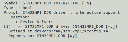

CONFIG_STM32MP1_DDR_INTERACTIVE is not the easiest configuration to enable because it implies to have already enabled other configurations.

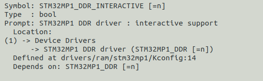

The first things to do is search “DDR_INTERACTIVE�?. To realize a search in the menuconfig, you have to hit “/�? key and type the text that you search.
A window like this appears:
As you can see, “STM32MP1_DDR�? is set to [=n] because you have to enable “STM32MP1_DDR�? before being able to enable DDR_INTERACTIVE.

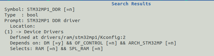

So search “STM32MP1_DDR�? .

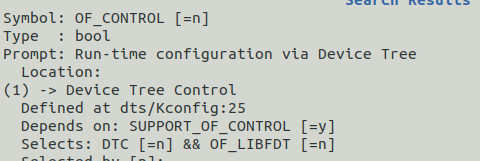

0693W00000HoWwyQAF.pngYou see that you have to enable "OF_CONTROL" and "ARCH_STM32MP" before enabling your configuration
So one more search, search for “OF_CONTROL�?
You can hit the key “1�? to directly go where the config is located or you can search it inside "-> Device Tree Control"
Enable the configuration.

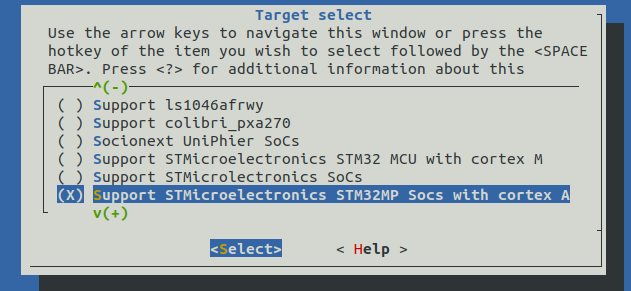

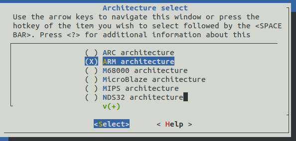

Then to enable "ARCH_STM32MP", you have to change the architecture type from Sandbox to ARM.
This can be done at the root of the menu:
Select ARM architecture in the list.

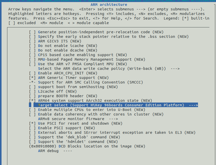

Now, a new menu appears “ARM Architecture�?. Go inside and looks at “Target select�?.
0693W00000HoX0HQAV.png Modify it to select “Support STMicroelectonics STM32MP Socs with cortex A�?

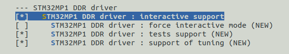

Finally, you can search again “DDR_INTERACTIVE�? and you will see that you enabled the needed “STM32MP1_DDR�? !
0693W00000HoX1KQAV.pngHit the key “1�? to go directly in the correct submenu or go in:
Location:                                                                               │
 │    -> Device Drivers                                                                     │
    │      -> STM32MP1 DDR driver (STM32MP1_DDR [=y])
And enable it.
The CONFIG_STM32MP1_DDR_INTERACTIVE configuration is now activated.
Be careful to save your modifications.

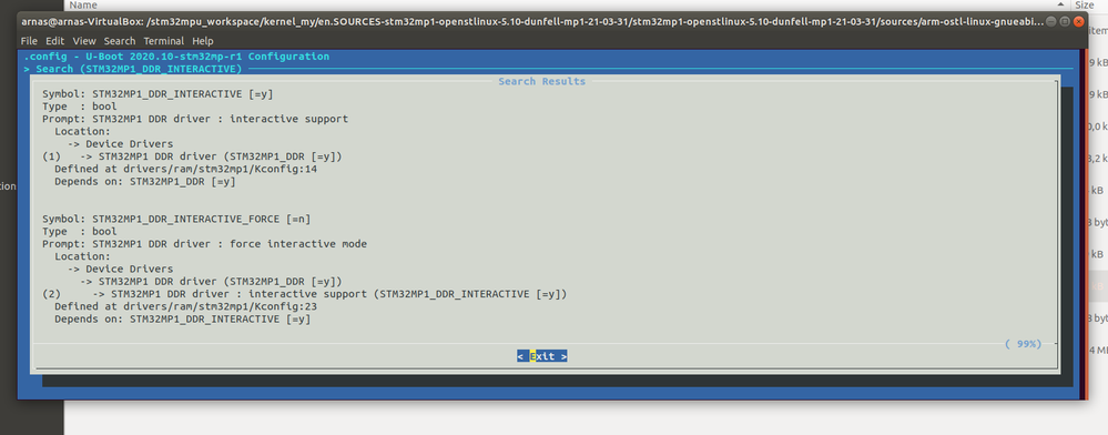

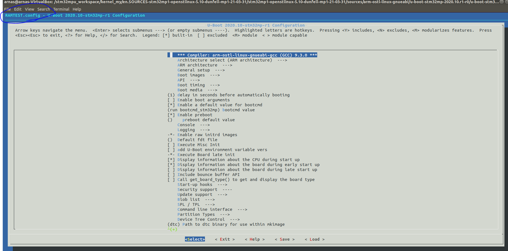

1. I have made changes to u-boot and menuconfig looks like this now:
_legacyfs_online_stmicro_images_0693W00000HoY08.png2.I have created a custom ***.config file and named it RAMTEST.config and followed the readme.txt
$ make RAMTEST.config
$ make DEVICE_TREE=stm32mp157c-dk2 all
Is this correct so far ? :?
Hi @Arnas Celkys​ ,
Great news!
How did you proceed to save your configuration in a RAMTEST.config?
Did you followed the chapter about savedefconfig? :https://wiki.st.com/stm32mpu/wiki/Menuconfig_or_how_to_configure_kernel#Menuconfig_and_Developer_Package
To be sure that "STM32MP1_DDR_INTERACTIVE" is enabled, before doing the "make DEVICE_TREE=stm32mp157c-dk2 all", you can open the file".config", in the U-Boot folder root and search the value of STM32MP1_DDR_INTERACTIVE .
It must be set to =Y
This file summarize all the configurations currently set that will be used during the build with the command "make DEVICE_TREE=stm32mp157c-dk2 all"
Regards,
Kevin

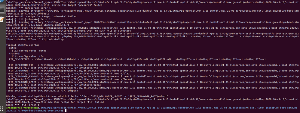

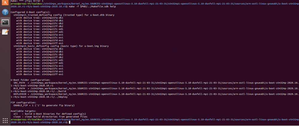

>>make -f $PWD/../Makefile.sdk help
>>export FIP_DEPLOYDIR_ROOT=$PWD/../../FIP_artifacts
Missing u-boot-stm32mp157a-dk1-trusted.dtb file in folder: '$FIP_DEPLOYDIR_UBOOT' or '$FIP_DEPLOYDIR_ROOT/u-boot'
/stm32mpu_workspace/kernel_my/en.SOURCES-stm32mp1-openstlinux-5.10-dunfell-mp1-21-03-31/stm32mp1-openstlinux-5.10-dunfell-mp1-21-03-31/sources/arm-ostl-linux-gnueabi/u-boot-stm32mp-2020.10.r1-r0/u-boot-stm32mp-2020.10.r1/../Makefile.sdk:136: recipe for target 'fip' failed
make: *** [fip] Error 1
0693W00000HoYe8QAF.png0693W00000HoYemQAF.pngecho $FIP_DEPLOYDIR_ROOT/u-boot
/stm32mpu_workspace/kernel_my/en.SOURCES-stm32mp1-openstlinux-5.10-dunfell-mp1-21-03-31/stm32mp1-openstlinux-5.10-dunfell-mp1-21-03-31/sources/arm-ostl-linux-gnueabi/u-boot-stm32mp-2020.10.r1-r0/u-boot-stm32mp-2020.10.r1/../../FIP_artifacts/u-boot
/stm32mpu_workspace/kernel_my/en.SOURCES-stm32mp1-openstlinux-5.10-dunfell-mp1-21-03-31/stm32mp1-openstlinux-5.10-dunfell-mp1-21-03-31/sources/arm-ostl-linux-gnueabi/FIP_artifacts/u-boot$ ls
u-boot-nodtb-stm32mp15.bin     u-boot-stm32mp157d-dk1-trusted.dtb
u-boot-stm32mp157a-dk1-trusted.dtb u-boot-stm32mp157d-ev1-trusted.dtb
u-boot-stm32mp157a-ev1-trusted.dtb u-boot-stm32mp157f-dk2-trusted.dtb
u-boot-stm32mp157c-dk2-trusted.dtb u-boot-stm32mp157f-ed1-trusted.dtb
u-boot-stm32mp157c-ed1-trusted.dtb u-boot-stm32mp157f-ev1-trusted.dtb
u-boot-stm32mp157c-ev1-trusted.dtb
$FIP_DEPLOYDIR_UBOOT - is empty
did i miss something? :D
Hi @Arnas Celkys​ ,
The recommanded way to generate the FIP is to create it automatically when you build your TF-A, please have a look to the README.HOW_TO.txt of the TF-A.
Please install it and build it by following this page if you do not have it yet: https://wiki.st.com/stm32mpu/wiki/STM32MP1_Developer_Package#Installing_the_TF-A
To learn more things about the FIP, you can read the ecosystem release note: https://wiki.st.com/stm32mpu/wiki/STM32MP15_ecosystem_release_note_-_v3.0.0#OpenSTLinux_-28Cortex-C2-AE-A7-29
or this part of the TF-A overview: https://wiki.st.com/stm32mpu/wiki/TF-A_overview#FIP
Regarding U-Boot
Since the ecosystem v3.0.0, two binaries are needed from u-boot:
https://wiki.st.com/stm32mpu/wiki/U-Boot_overview#Output_files
u-boot.dtb and u-boot-nodtb.bin
I recommand you to build with a command line like this: make -f $PWD/../Makefile.sdk DEVICE_TREE=stm32mp157c-dk2 uboot
u-boot instead of all in last parameter, to only generate u-boot binaries.
For what I know, you have too manually copy them from your U-Boot build directory to the FIP directory (FIP_artifacts/u-boot).
But before doing the copy I recommend you to rename the file u-boot-nodtb-stm32mp15.bin and u-boot-stm32mp157c-dk2-trusted.dtb to keep a copy of them.
The files that need to be copied from your build directory to the FIP directory are:
u-boot-nodtb.bin -> u-boot-nodtb-stm32mp15.bin
arch/arm/dts/<your-board-file>.dtb -> u-boot-stm32mp157c-dk2-trusted.dtb
Once you have copied the U-Boot files in the FIP directory, you will be able to generate the FIP when you build your TF-A.
Regards,
Kevin
NEW ! Sidekick STM32 AI agent, see here

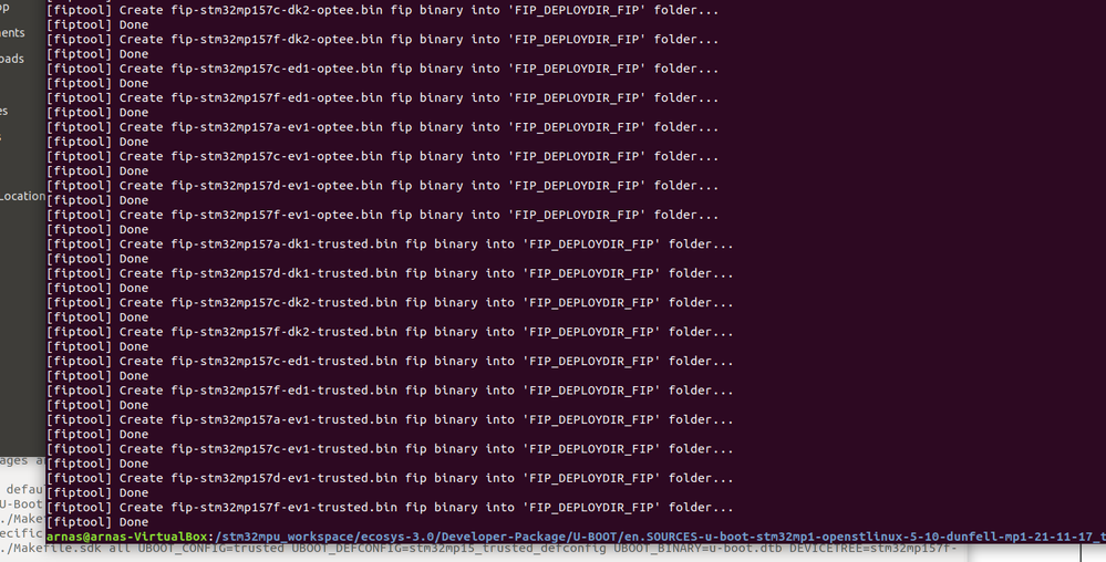

I have cleaned the project and started all over using the TF-A. And I believe i managed to build FIP according to my changes. My mistake was that when following README.HOW_TO.txt i was following "5.1 Compilation for one target (one defconfig, one device tree) - and no FIP" when I should have been using the "5.2 Compilation for several targets: use Makefile.sdk (with FIP)" because I have TF-A installed - atleast my this is my guess :D
_legacyfs_online_stmicro_images_0693W00000HogFV.pngso now I have successfully have generated all versions of ***.bin and ***.dtb (example: u-boot-stm32mp157c-dk2-trusted.dtb and fip-stm32mp157c-dk2-trusted.bin) files according to "myboot.config" content. Atleast I am guessing they follow my config file - no way to know untill I upload them right?
What should be the next step now, how should i upload them them now? Thanks! :)
