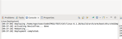

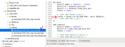

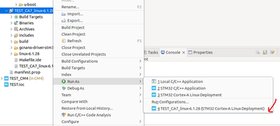

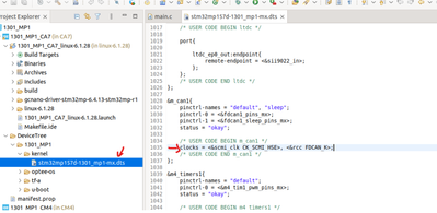

2024-03-06 6:58 PM
How to manage OpenSTLinux projects in STM32CubeIDE - stm32mpu
You should install openstlinux according to the link above, then configure CAN in stm32cubeide, then deploy to stm32mp1 board
