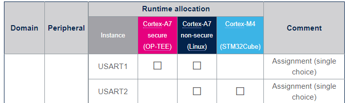

The USART1 is a secure instance (under ETZPC control) as explained here: https://wiki.st.com/stm32mpu/wiki/USART_internal_peripheral#Security_support
That means that the USART1 can be configured as Secure, but also as a non secure device.
You can also find in the same wiki page, the peripheral assignment array: https://wiki.st.com/stm32mpu/wiki/USART_internal_peripheral#Peripheral_assignment
Which confirms that the USART1 can be assigned to Secure or non-secure world.
