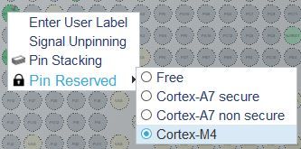

Hi, I am currently looking at how to enable a GPIO pin on the M4 with the MP157A-DK1 kit.
In the datasheet it is unclear to me how I can assign the gpio pin specifically to one of the two processors (A7 or M4) or is this not necessary?
Thanks,
Rens
2020-02-04 7:26 AM
Once GPIO is set in CubeMx, use Right-Click to assign to Cortex-M4.
This will ensure the generated code is present in main.c
Regards
