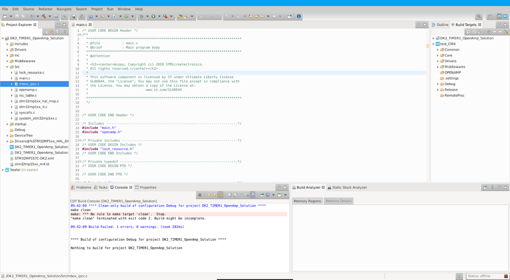

When I hit the build button, I get "Nothing to build for project DK2_TIMER1_OpenAmp_Solution", the Debug folder is also empty, should this be populated or do I need to generate it somehow?

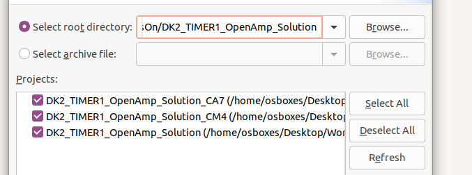

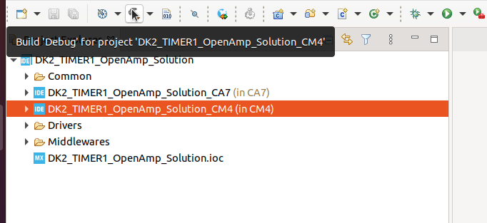

Click on finish and select "DK2_TIMER1_OpenAmp_Solution_CM4" in the project explorer and click on the build icon (hammer):
You must be able to build the project.

2022-01-31 9:11 AM
Hello @msche.1 ,
I assume that you followed the step from the video.
Please can you send me a screenshot of your project explorer on the left side of CubeIde and the complete log from the CubeIde Console when you hit the hammer (build button).
Regards,
Kevin
2022-01-31 9:44 AM
Yes, I followed the steps. Basically just unzipped, imported and built.
