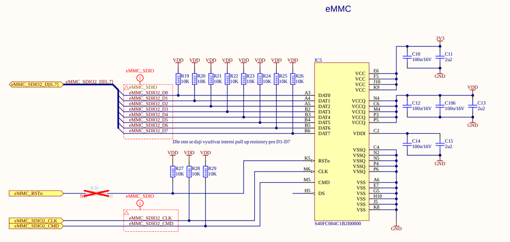

2021-09-29 5:23 AM
No, the main supply is 3v3 but the communication logic (signal voltage) uses the 1v8. I attach the schematic of the eMMC.
