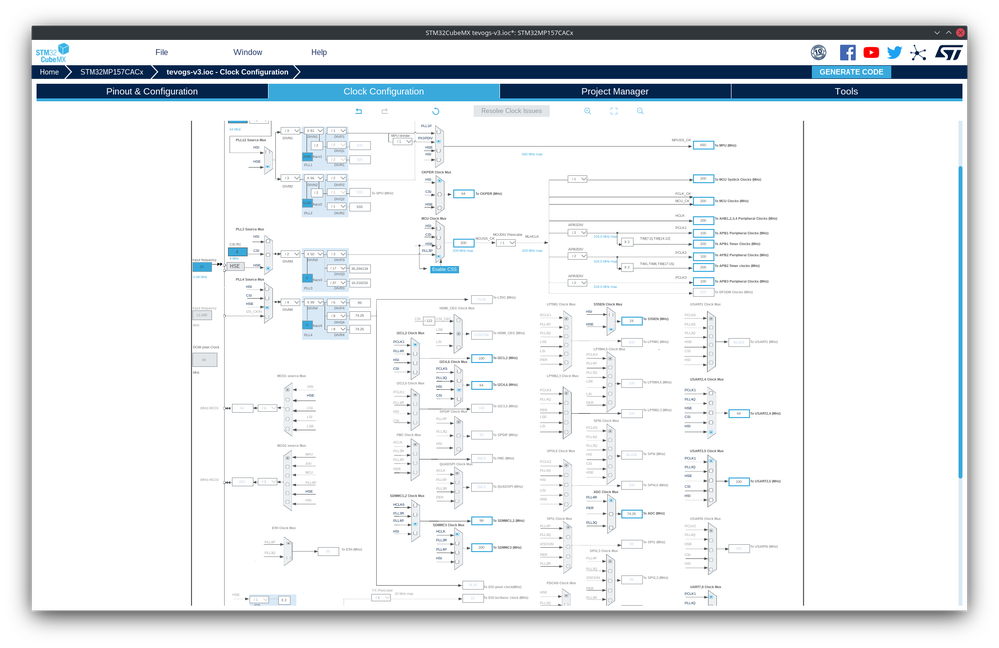

2021-08-26 2:07 AM
Our clock tree is configured like this:I think this should be correct. Isn't it? Should I alter the SDMMC clock source? Can you guide me if so, please?
Best regards,
Tomáš.
