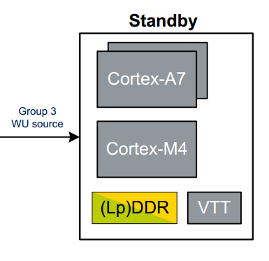

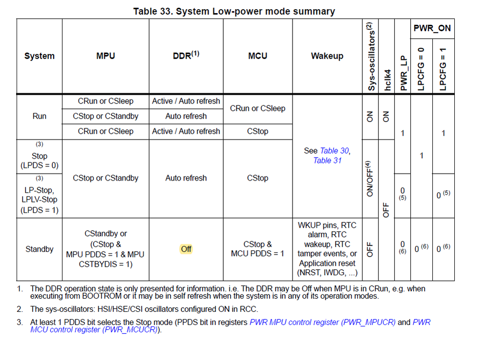

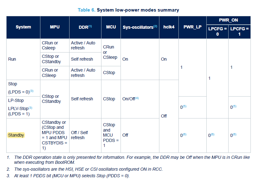

2019-07-18 5:09 AM
Thank you very much for your answer. I'm still a beginner for low power mode and linux kernel, so I'm sorry that I have so many questions to ask.
1.The Table 33 in doc STM32MP157xxx reference manual RM0436.pdf mentions that DDR is off in System Standby Mode:
However, if DDR is off, the platform must be reboot after wakeup. But in the doc AN5109 low power application note , Figure 7 shows that DDR isn't off, the Table 6 shows that the DDR status is off or self refresh:
So what is the true state of DDR?

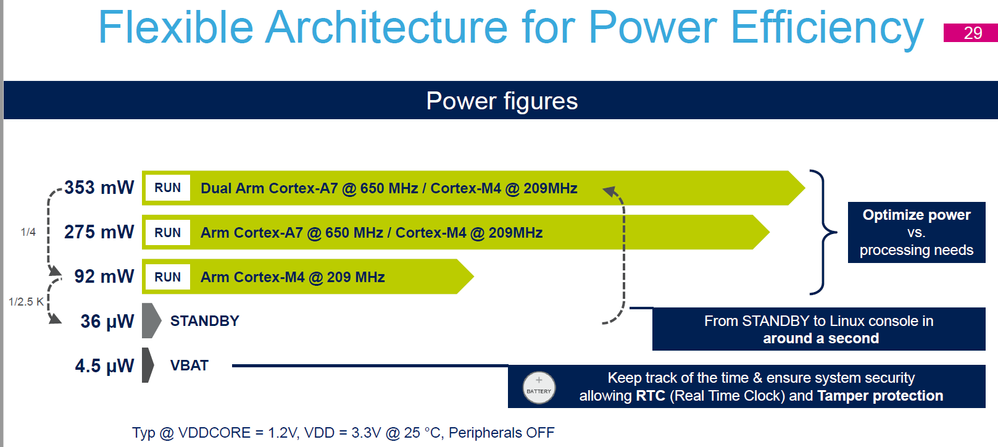

2.How do you define the Wakeup Time after exiting from System Standby Mode? The ppt STM32MP1 Microprocessor - Continuing the STM32 Success Story mentions the wakeup time is around 1 second,
But if I count all the log time after pressing the wakeup button, it's more than 2s.

2019-07-18 7:13 AM
1/ in Standby mode, you have the choice to switch off the ddr or to keep it in self refresh "SR" (both are supported).
2/ 1 sec for standby wake up is what is achievable for a final product. We already confirmed this value customizing a bit the SW on DK2. DK2 standard delivery is a development platform so not optimized for power (even if all the power mechanisms are present and can be experienced). For example, full debug is activated and almost all the peripherals.
A wiki page is under construction to show how to reach better power results with ST boards.
