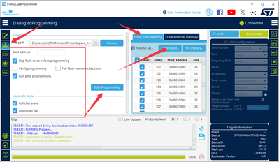

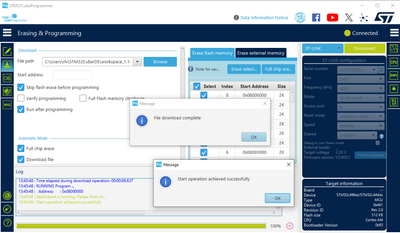

2025-03-26 10:48 PM
STMicroelectronics ST-LINK GDB server. Version 7.8.0
Copyright (c) 2024, STMicroelectronics. All rights reserved.
Starting server with the following options:
Persistent Mode : Disabled
Logging Level : 1
Listen Port Number : 61234
Status Refresh Delay : 15s
Verbose Mode : Disabled
SWD Debug : Enabled
InitWhile : Enabled
Waiting for debugger connection...
Debugger connected
Debugger connected
STM32CubeProgrammer v2.17.0
Log output file: C:\Users\rlv\AppData\Local\Temp\STM32CubeProgrammer_a26804.log
ST-LINK SN : "
ST-LINK FW : V2J45S7
Board : --
Voltage : 3.30V
SWD freq : 4000 KHz
Connect mode: Under Reset
Reset mode : Hardware reset
Device ID : 0x461
Revision ID : Rev 2.0
Device name : STM32L496xx/STM32L4A6xx
Flash size : 512 KBytes
Device type : MCU
Device CPU : Cortex-M4
BL Version : 0x93
Debug in Low Power mode enabled
Memory Programming ...
Opening and parsing file: ST-LINK_GDB_server_a26804.srec
File : ST-LINK_GDB_server_a26804.srec
Address : 0x08000000
Erasing memory corresponding to segment 0:
Erasing internal memory sectors [0 277]
Download in Progress:
Error: failed to download Segment[0]
Error: failed to download the File
Encountered Error when opening C:\ST\STM32CubeIDE_1.14.1\STM32CubeIDE\plugins\com.st.stm32cube.ide.mcu.externaltools.cubeprogrammer.win32_2.1.400.202404281720\tools\bin\STM32_Programmer_CLI.exe
Error in STM32CubeProgrammer
Shutting down...
Exit.
Step 1: Full chip erase
