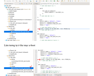

u should add  clocks = <&scmi_clk CK_SCMI_HSE>, <&rcc FDCAN_K>;  into
&m_can2{ pinctrl-names = "default", "sleep"; pinctrl-0 = <&fdcan2_pins_mx>; pinctrl-1 = <&fdcan2_sleep_pins_mx>; status = "okay"; clocks = <&scmi_clk CK_SCMI_HSE>, <&rcc FDCAN_K>; };
Hello @ngoctoan150699 ,
Thank you for your reply. Now everything works!
