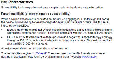

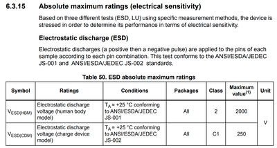

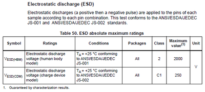

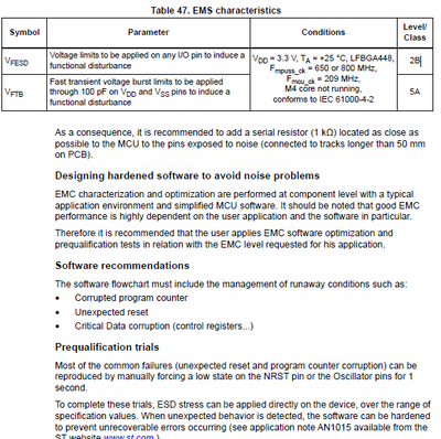

HI @DKUMA.11
I'm not ESD expert, but I can say that we guarantee the following ESD (IC product) values:
The IC Datasheet specify both:
Note that the STM32MP157x-DK2 board is a development board and might not be designed to fit specific environmental requirements.
I think resistance to ESD strikes on a product should includes casing, shielding as well as power supply routing/decoupling or other sensitive signal isolation/decoupling/filtering.
TVS or similar component are mostly for protecting the device to be damaged, but does not avoid energy flow thru supply/ground. Careful system design analysis might be needed (usually involves customer experience in their product field area).
In your case, maybe worth to focus on current paths used during strikes, there could be something to enhance on PCB ground layer or more direct path to ground (e.g. direct connector ground to metal casing/shielding).
Then, as a mitigation, you should also find a way to detect the misbehavior and issue a watchdog reset.
