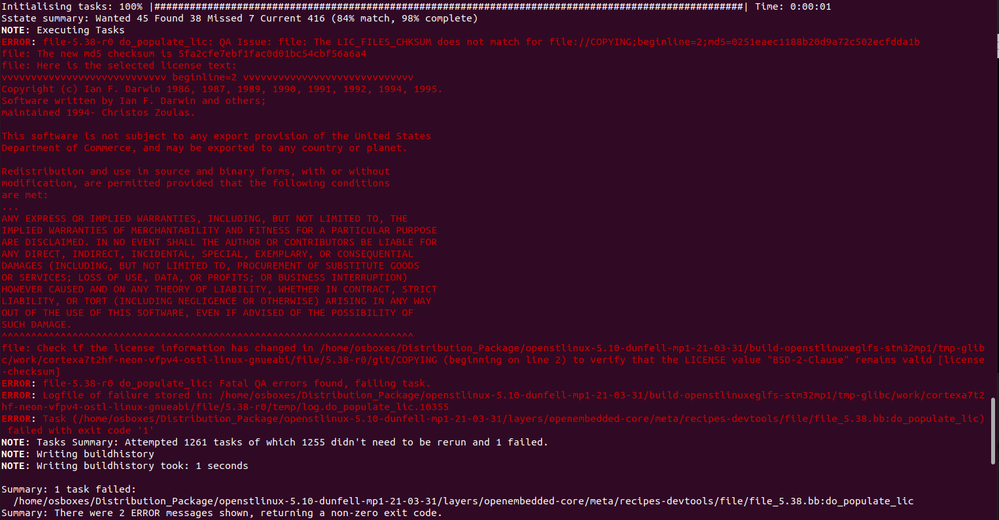

I understand that. I haven't made any changes to the file that is mentioned in the error-log. I have tried to change the checksum to the suggested one but it still doesn't work.
This is what I have done:
I changed the LIC_FILE_CHKSUM in /Distribution_Package/openstlinux-5.10-dunfell-mp1-21-03-31/layers/openembedded-core/meta/recipes-devtools/file/file_5.38.bb line 9, from md5=0251eaec1188b20d9a72c502ecfdda1b to md5=5fa2cfe7ebf1fac0d01bc54cbf56a6a4
I attach a screenshot of the error.

Hi @Community member
Hum, that's strange. Could you revert your changes to the LIC_FILES_CHKSUM and then run the commands to clean the bitbake cache please?
$ bitbake -c cleansstate file
$ bitbake -c cleansstate libndpThen, re-launch the commands:
$ bitbake file
$ bitbake libndpBest regards,
--JM

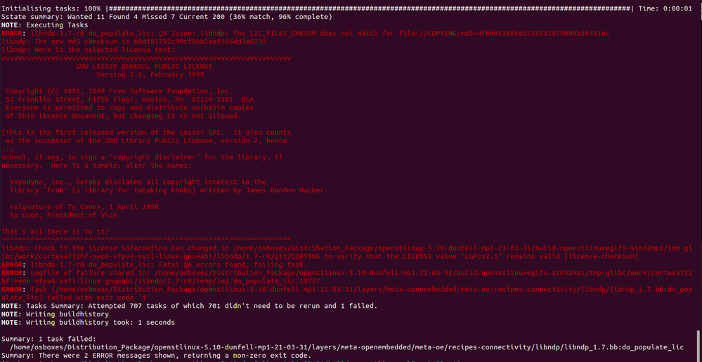

2021-09-09 1:59 AM
Unfortunately, it didn't work. I did the cleansstate first and took screenshots of the errors while trying to bitbake file and libndp:Best regards,
Jacob
I just clone the GIT repository of file and it gives me the expected checksum. Could you check your recipe file_5.38.bb in layers/openembedded-core/meta/recipes-devtools/file shows the line
SRCREV = "ec41083645689a787cdd00cb3b5bf578aa79e46c"Same thing for the GIT repository of libndp: it gives me the expected checksum. So could you check your recipe libndp_1.7.bb in layers/openembedded-core/meta/recipes-connectivity/libndp shows the line
SRCREV = "96674e7d4f4d569c2c961e865cc16152dfab5f09"If yes in both cases, it may be a problem with the downloaded packages. From your home directory, go to the directory Public/oe-downloads/git2 and remove the entries related to file and libndp. That should be the commands
$ cd ~/Public/oe-downloads/git2
$ rm -rf github.com.file.file.git* github.com.jpirko.libndp*Then, replay the bitbake commands to build file and libndp
Best regards,
--JM
edit : remove spurious line after my signature
