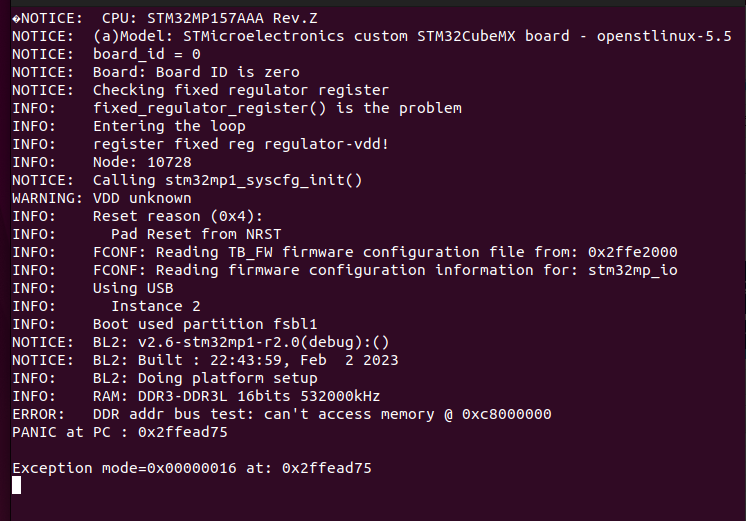

I've been validating my DDR interface with DDRUTIL through the CubeMX DDR Interactive which seems to pass the tests. When I boot TF-A it is failing both address bus testing for 1's and 0's. But I can run this same test through DDRUTIL and it passes. What am I overlooking here? As for DDR configuration in either case, the files are identical.
Here are the results of doing an address bus test (which per the comments is exactly what TF-A is doing)

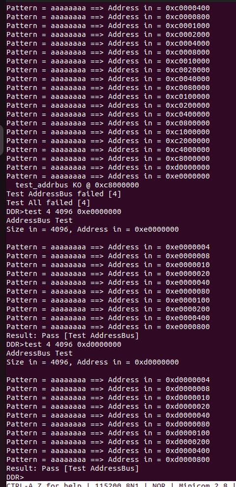

Some additional information I discovered...
Using DDRUTIL I can get the same failure TF-A is giving me if I run all the tests (i.e. test 0). When I run all the tests test 4 will fail at the same address 0xc8000000. What's more interesting is if I run test 4 and start increasing the size of test 4 across 0xc0000000 - 0xc8000000 and 0xd0000000 - 0xd8000000 and so forth I can get passes. Here's a snippet

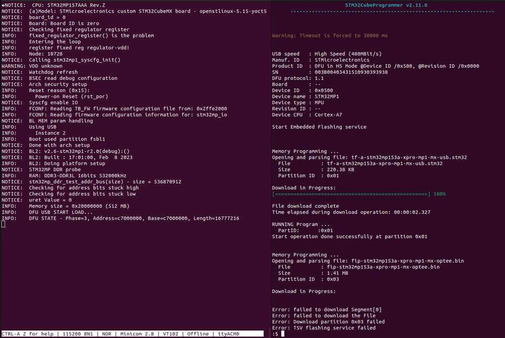

Correct Patrick, Its a single DDR3L x16 of 8Gbits. Okay on how the bus width only affects the CTRL and PHY registers. Originally I did have the configuration set exactly has you've shown but I get failures when running tests like DDRUTIL test 0 which will run all the tests it will fail address bus test every time TF-A boot will fail its address bus test as well since it's the same test. What became really confusing is I could still do a simple single test on those address points, like test 4 in DDRUTIL and get a pass. By cutting the density in half it seems to fix the issue in both DDRUTIL and TF-A tests. And in reality I will never use even 512MB of DRAM so not a huge issue at the moment assuming I can get the rest of the process to work. As for wiring the DDR, yes A[15:0] are wired. Schematic is included here just in case you can find something I've missed.
What's interesting is I can now get through that initial TF-A (FSBL) boot where it want's to load FIP and it's getting stuck for like 30+ seconds then says it's downloading FIP but never does and just fails. So I'm wondering now if that's a related DDR issue.

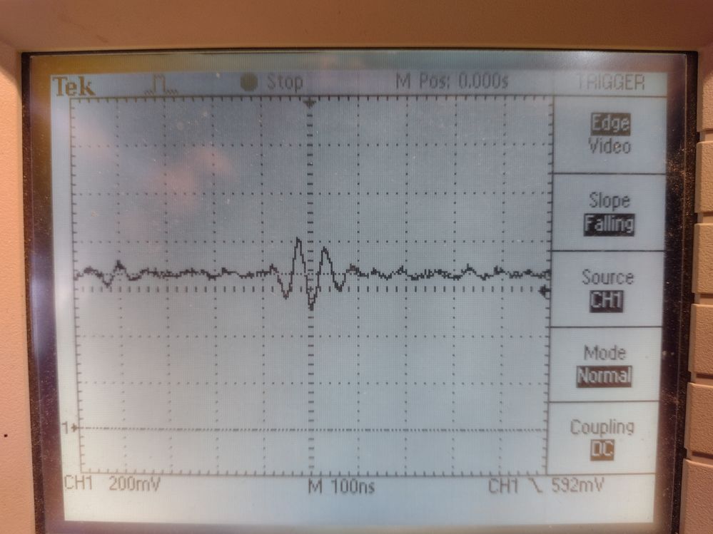

Gotcha, yep I remember both of those app notes very well. I apparently overlooked that. Here's a snap shot of my VTT line even during running all DDRUTIL tests. That's the worst of it but maybe enough to cause an issue. It is around 200mVp-p. Reviewing the PCB those two signals VREFDQ and VREFCA are accessible and I could fix that.
Yeah, we've had these boards x-rayed and soldering was pretty well spot on but I suppose you can't catch everything with x-ray either.
