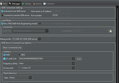

In debug configuration, tried selecting Debug Probe ST-LINK GDB Server
Those are the debug configurations:

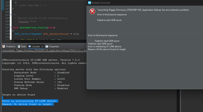

I get the following message:
"Failed to start GDB server. Error in initializing ST-LINK device. Reason: (4) No device found on target."
Tried in ST-LINK GDB Server mode to change the Reset Behaviour, modify the frequency, didnt help.

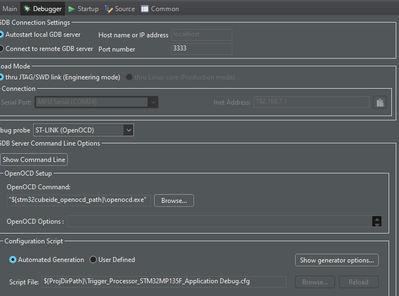

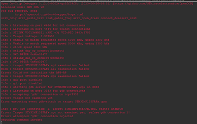

Tried Debug Probe ST-LINK(OpenOCD) with the following configuration:
I get the following text:

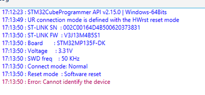

Also tried using STM32CubeProgrammer and attempted connecting to the DK, with various configurations, I only get "Error: Cannot identify the device"

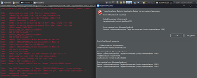

I still get the following error:
I would very much appreciate any assistance.
